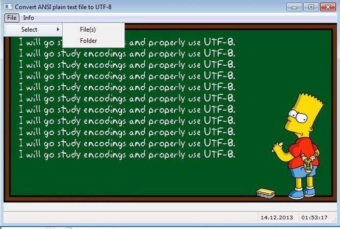

Hi All
Notre ami Serge Girard gave some good enhancements : Error-tolerant file delete and rename and a nice background image :arrow:
Screen shoot of ANSI -> UT8 conversion - 2
CFANS2UT8-2(src).zip
Source file of ANSI -> UT8 conversion - 2
(52.6 KiB) Downloaded 388 times
CFANS2UT8-2(exe).zip
Executable of ANSI -> UT8 conversion - 2
(1.16 MiB) Downloaded 350 times
