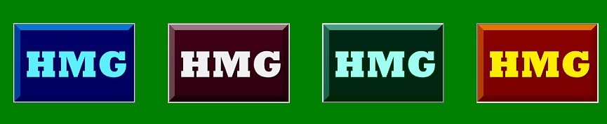

My two cents :
Some experimental HMG logo works
DrawEdgeImages.zip
HMG Logo Pictures and changed .fmg
(24.97 KiB) Downloaded 398 times
As far as I understood, sadly there isn't color option :(
But I guess may be possible changing edge parameters ( thickness and others ) by user interactively :?
And a little problem : when screen changed ( fe selecting another task ) edges goes away :?
Anyway thank to share Pablo :arrow:
Viva HMG :D

DrawEdge - New feature
Very nice Esgici (I liked those HMG pictures), thank for your interest too. But how you solved the compilation ? Was any wrong in your updates in 3.1.5 ? Why is not accepting Form.HANDLE ? Any reason ?
esgici wrote:As far as I understood, sadly there isn't color option :(
Well as I already said, this is an useful function provided by the Win32 API (MSDN - Microsoft) I do not know if this could it be posible.
The good news is this feature could it be added to the existing controls. There is also this question [exturl]viewtopic.php?p=31180#p31180]made here [/exturl] to Dr. Soto which I guess to be possible to implement it keeping particulars with Win32 API features.
esgici wrote:And a little problem : when screen changed ( fe selecting anther task ) edges goes away :?
This I have noted and I was going to clarify it. But for at beginning seems quite easy to solve it until the community and Claudio decide if it would be interesting to have it in intricately components (as I mentioned in another topic Mustafa). From now, to keep it DrawEdge alives you can set it at:
ON SIZE
ON MAXIMIZE
ON GOTFOCUS
I will see what can be done for this question. Thanks again for your observations. :)

Re: DrawEdge - New feature
Pablo César wrote:Optimized code and added a FRAMEs options too (not so nice) but can gives an idea to replace frames for DrawEdge.
Very Nice Pablo!!!
PS: After using the handle DC you must release, example:
Function Set_Screen5()
Local hDC:=GetDC(Screen_5.Handle)
DrawEdge( hDC, GetControlCoords("Screen_5","List_1",2), EDGE_BUMP  , BF_RECT )
DrawEdge( hDC, GetControlCoords("Screen_5","List_2",2), EDGE_ETCHED, BF_RECT )
DrawEdge( hDC, GetControlCoords("Screen_5","List_3",2), EDGE_RAISED, BF_RECT )
DrawEdge( hDC, GetControlCoords("Screen_5","List_4",2), EDGE_SUNKEN, BF_RECT )
ReleaseDC (Screen_5.Handle, hDC)
