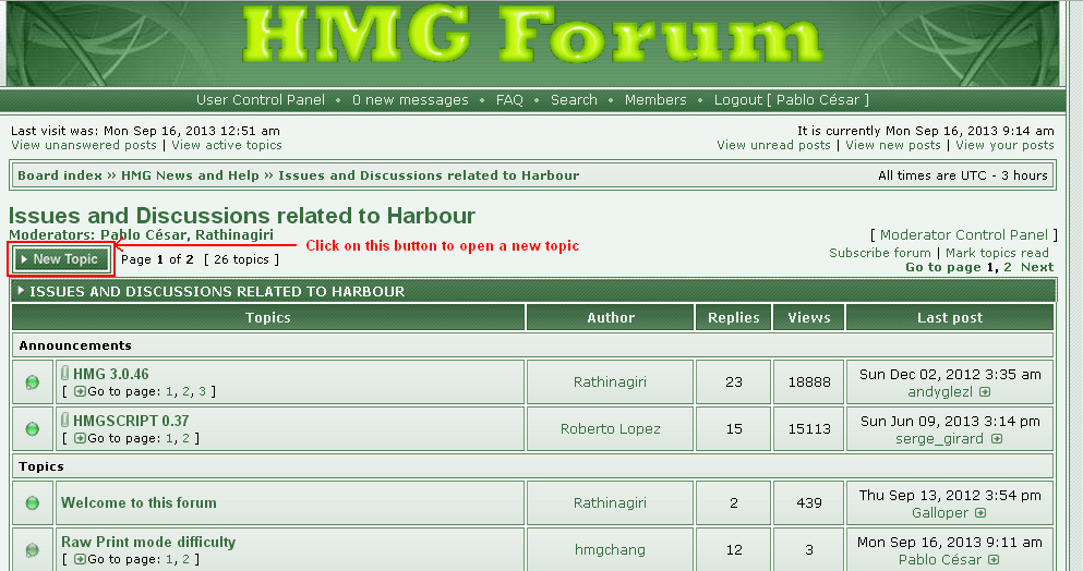

1. You can select your forum according your main matter of the message that you wish to post. Each section, has it own matter. For this matter of from your begining of this subject I thought was ok for this section "Issues and Discussions related to Harbour". After selecting the right section, by clicking seing from "Board index" page (index of all forums sections). You will find a "New Topic" button (see picture):

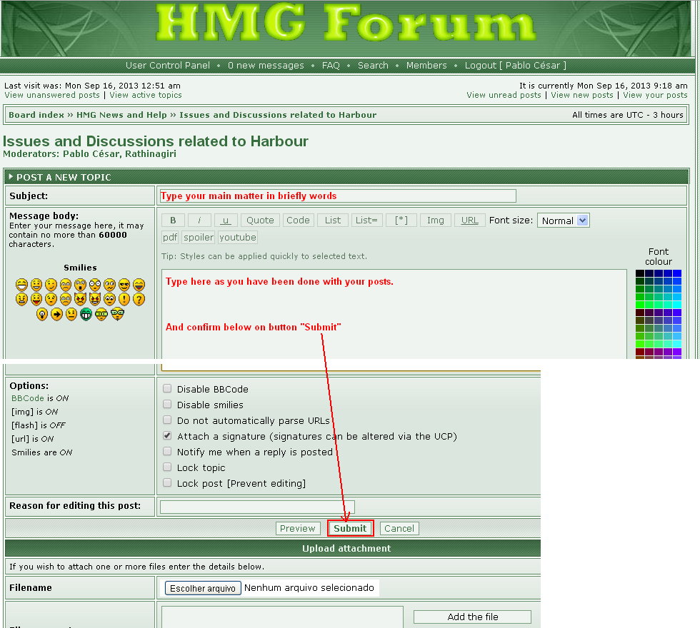

After this, I think you already know how to submit your messages:
