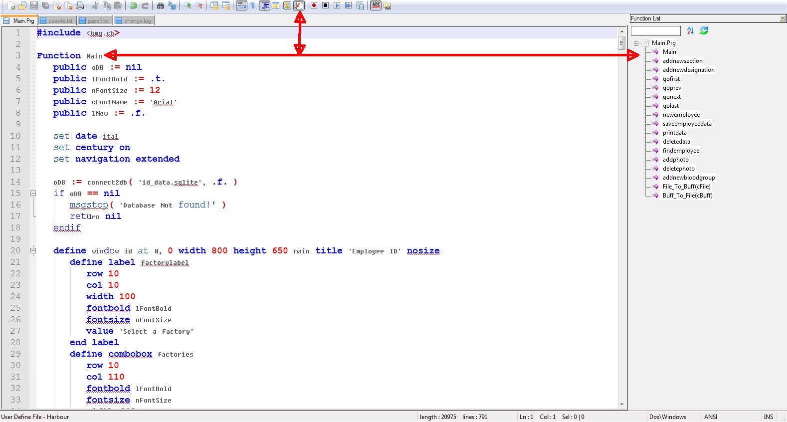

I have changed functionlist.xml as given by Pablo to list all the functions even without parenthesis.
			<parser id="prg_function" displayName="Harbour" commentExpr="">
				<function
				    mainExpr="^[\t ]*(!Func|Function|Proc|Procedure)[\t ]+[^\r\n]*$"
					displayMode="$functionName">
					<functionName>
						<nameExpr expr="(?(?=[\t ]*)[\t ]*[\t ]+[^\s]+|[^\r\n]*)"/>
					</functionName>
				</function>
			</parser>
This was the parser code.
Please see the screenshot.
Re: Notepad++ Function List

It is already been explained in detail by Pablo. You have to include this code in functionlist.xml found in either notepad++ folder or appdata folder.
I had installed the recent version of NotePad++ which is 6.6.9

Rathinagiri wrote:Hi,
				<function
					<functionName>
					</functionName>
				</function>
			</parser>
At last!
For a long time I was struggling with this thing, with no avail..
Many thanks for your hint! you're great! 8-)
Pete
