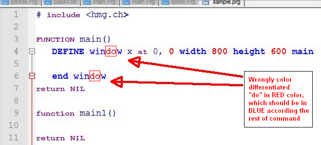

Also, as you can note down, 'do' in win'do'w is also taken as DO and a separate loop is created. Can't we avoid that?
This wrong color differantiation is probably from highlighted rules, (maybe becomes from here). I still do not alter anything about it, I'll see that later.

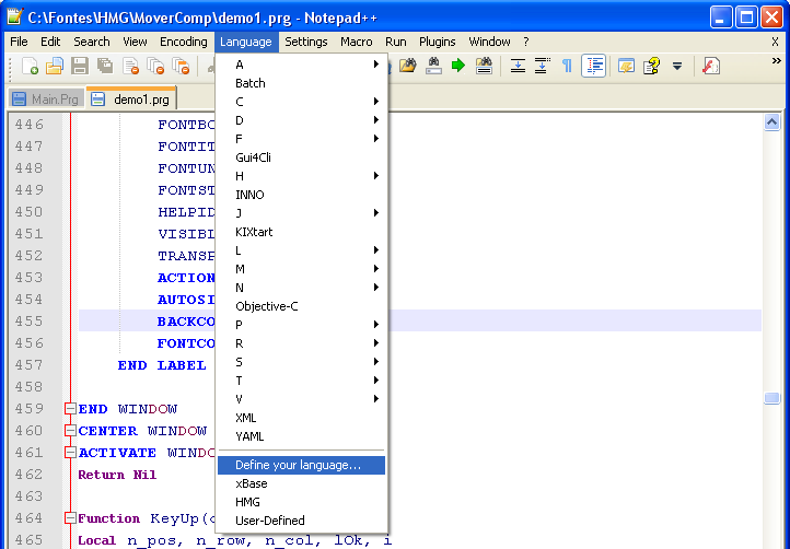

Rathinagiri wrote:Also, as you can note down, 'do' in win'do'w is also taken as DO and a separate loop is created. Can't we avoid that?
I found the error !!!

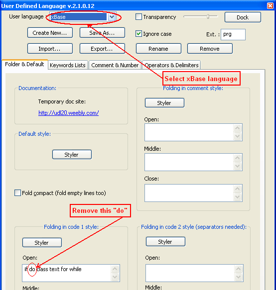

Go to Settings/Define your language
Select "xBase" language and remove command "do" at "Folding in code 1 style", as showing picture below:
Then you can close with by th "x" and ready !! 8-)
