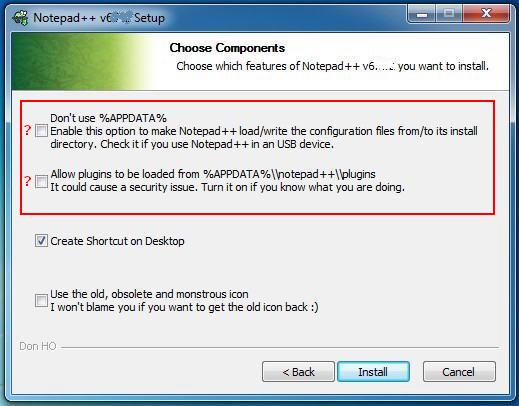

After I've been thinking that all that was talked about earlier was based on concepts and my own experience. But I confess that before there are various ways to install and use of Notepad++ and we should assess the risks and options that Notepad++ is offering during installations.
I say by facing this screen:
Therefore I will make several tests for installation and checking if is loosing pre-configurations.

Let me extend this matter of Notepad++ screen options of components. By this screen:
Notepad++ says:
1._ Don't use %APPDATA%
     Enable this option to make Notepad++ load/write the configuration files from/to its install directory. Check if you use Notepad++ in an USB device.
2._ Allow plugins to be loaded from %APPDATA%\\notepad++\\plugins
     It could cause a security issue. Turn it on if you know what you are doing.
My doubts:
Note: When it's says %APPDATA% it will means that it will be installed in Program files folder from USER directory. This is very important when the computer is shared by many users, which other users could not access (due users right access in Windows).
In item 1, I think this is only used when we want instalation to be an a different folder (not "Program files" folder) and placed all files at one folder and this included Notepad++ configurations files and plugins. This is usefull for pendrive cases and probably would it be a good option for us.
But the problem is this item 2 that seems to combine two new options: plugins "IN" or "OUT" of installation folder. And this "OUT" option (plugins will set to USER's configurations folder) certainly will be prevented by security Windows system when others users needs to share plugins or any configurations files.
Your suggestion to create an installation program for Notepad++, could be good. Because we can let FIXED options, but the main problem is when Notepad is claiming by the auto-upgrade and user could choose to make it by another Notepad++ way of installation. So IMO, user should install ALWAYS in the same way just to avoid any configuration loossing.
So all these doubts I need to clarify. Help and comments will be good accepted.

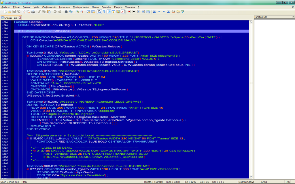

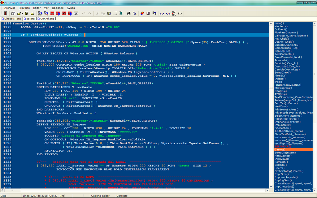

The attached file is a copy of Notepad++ (latest version) with the following plugins to be tested and appreciated:
  • 1. Auto-Completion
    2. Function List
    3. Language Help (HMG / Harbour)
    4. Quicktext
If you want to see how each of these plugins, unzip the file Notepad++.Rar in a folder. By clicking with the right mouse button, in context-menu select the option "Extract to Notepad++\". Then it will creates a new folder with the name of "Notepad++" in your hard disk. So from now on, you can execute this version of Notepad++ from that folder that is ready for use, ie., is already with all these plugins configured.
If you run the Notepad++ will open a new blank document called "new 1" that is in the "Normal text" format, so we have to try to rename the opened file for PRG or select in the menu, the programming language. In our case, the programming language is xBase.
Once selected the xBase language, you can do these tests:
- Type within the text editor, the following string: ach
   then will displayed Achoice option of combobox to be selected.
   You can choose by Image (Enter key).
   After selecting function by Auto-Completion, you continue to type opening parenthesis -> (
   then you will see the syntax of slected function. And as you typing will appear
   highlighted each parameter of the syntax function.
- If you open a PRG file with its various functions within, you can test the Function List
   by clicking at followin button:
   Then will be displayed all the functions mentioned in your PRG file.
- You can test Language Help (HMG / Harbour) by typing:
   textbox and click with the right button of the mouse and one context-menu
   will be displayed. You can choose HMG to see in chm file the syntax of textbox.
- To see how it's works the Quicktext, type within the text editor, the following string:
   BUTTON (in upper case) then press Image (TAB key) to see the result.
   (Click here to see demo video)
I hope I have been able to present the best features of plugins that make it much easier for sure in edition of our source codes and I hope you all enjoy.
Important note: This is not our final statement nor a procedure for installing Notepad++. This a Notepad++ installed package is just to test the capabilities of those plugins. Installing Notepad++ in your computer will be made by the user if you choose this as the default editor of your source code.
Later I will instruct a more convenient way for all of us about how to install Notepad++ without losing settings after future updates of this editor.
Notepad++.rar
(5.49 MiB) Downloaded 2083 times

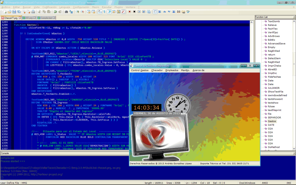

Re: Notepad++ Installation / UpGrade
Hola Pablo César
Gracias por tu investigación sobre el Notepad++
Yo estoy experimentando con el, y ya logre darle una "vista" parecida a la que tenia en el "xMate"
Lo que no he podido, es que me muestre la lista de funciones al lado derecho.
Hi Pablo Cesar
Thank you for your inquiry into the Notepad + +
I'm experimenting with, and achieve and give a "view" similar to the one I had in the "xMate"
What I have not been able, is to show me the list of functions on the right side.
Hola Pablo César
Estoy utilizando el ejecutable desde: C:\Archivos de programa\Notepad++
Y copie los archivos .xml que enviaste, a: C:\Documents and Settings\Administrador\Datos de programa\Notepad++
( %APPDATA%\notepad++ ) y ya lo conseguí.

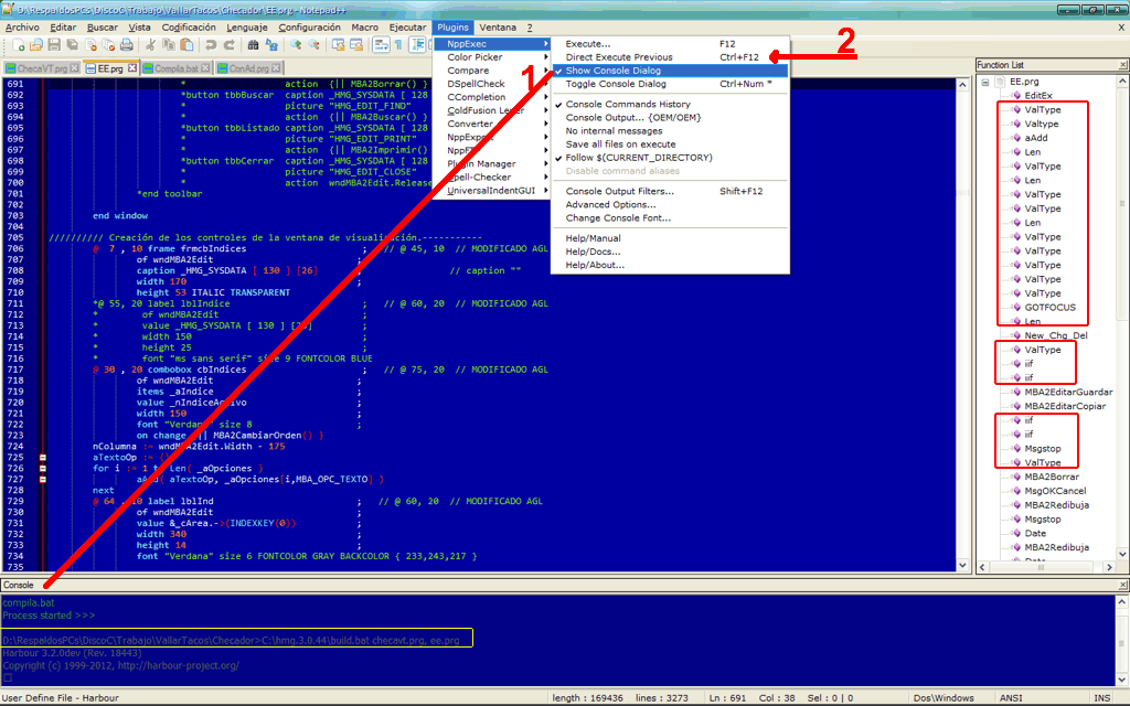

Instale el plugin "NppExec" (para ejecutar el .bat de compilación) y con esto, mi ciclo es:
1.- Modifico el fuente
2.- Ctrl-S (guardo modificaciones)
3.- Ctrl-F12 (ejecuto el .bat de compilación)
Hi Pablo Cesar
I'm using the executable from: C:\Program Files\Notepad++
And copy the .Xml you sent to: C:\Documents and Settings\Administrator\Application Data\Notepad++
(% APPDATA%\Notepad++) and i got it.
Install the plugin "NppExec" (to run the .Bat compilation) and with this, my cycle is:
1. - I modify the source
2.- Ctrl-S (keep changes)
3.- Ctrl-F12 (run the. Bat compilation)
El .bat es simple, solo lleva esto (en mi caso):
C:\hmg.3.0.44\build.bat checavt.prg, ee.prg
Y en el programa, hacer lo siguiente:
Despues de activar "Show Console Dialog",
1.- hay que digitar dentro de la ventana "Console" el nombre del .bat
y oprimimos "Enter" para ejecutarlo. (solo la primera vez).
2.- Las siguientes veces, solo oprimimos "Ctrl-F12" para ejecutarlo.
The .bat is simple, just take this (in my case):
And in the program, do the following:
After enable "Show Console Dialog"
1.- There to type in the window "Console" name .bat
and oppressed "Enter" to execute. (first time only).
2.- The following times, only oppressed "Ctrl-F12" to run it.
Lo que no me agrada, es que en la lista de funciones aparecen todos los llamados a las
funciones que contiene el .prg, pero podría ser configuración, cuestion de seguir buscando.
What I dislike is that in the list of functions are all called to the
containing functions. prg but could be configuration issue to keep looking.
