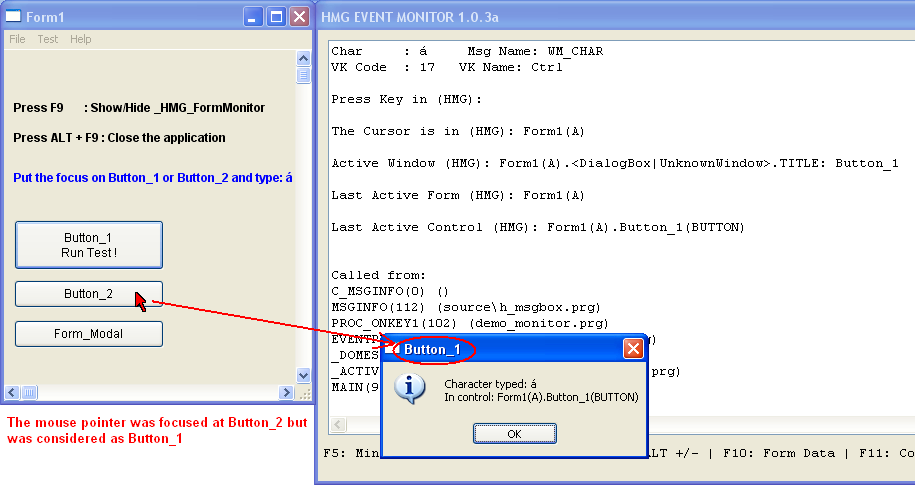

I found nothing about "ANIMATE WINDOW" command throughout your code. :cry:
I was fascinated with your code and I would like to contribute with some changes that I believe will provide a better interface:
- I changed the position and size of each window, because depending on the screen resolution, it is difficult to interact.
- I put the the "Modal Window" in separate function, just for be called via a button.
- HMG_InstallEventMonitor was add a label with options.
- I changed the string from Tamil to Arabic because it is visible in some cases where Windows XP does not have support for Asian linguaguem (Case CueBanner).
- There is a problem when is focused on Button_1 and Button_2, MsgInfo is incorrect according Mouse Pointer be focused (see screen captured below):
Probably this mistake needs a different approaching for to be solved. :?
