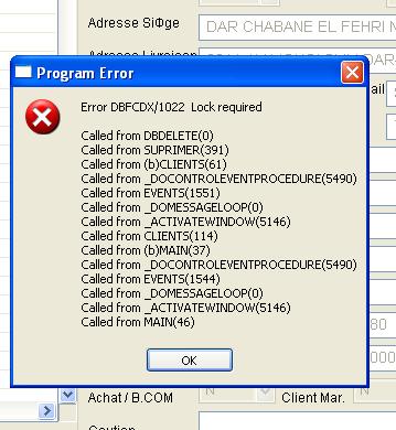

when I want to delete a record in your example (client.rar), I receive this message
how to remedy please
Procedure SUPRIMER()
		  If MsgYesNo ( 'Vous étes Sur de vouloir Supprimer ce Client')
			If Client->(FLock())
			  Delete
			   Win_1.Browse_1.Delete
			   Win_1.Browse_1.EnableUpdate()
			   Win_1.Browse_1.Refresh
			  Unlock
		  EndIf

Re: First topic, please help with little project
Salam Aleyk Tabet
Please look at here, I hope will be useful :)
