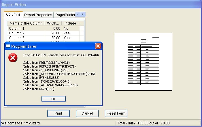

7. C:\hmg.3.1.4\hfcl\Samples\GridPrintPreFormat, Main.,prg need to correct at line of:
     a.Image Form_1.Grid_1.Item (2) := { 123.45 , date() , 2 , 10 , .T. }
     to be replaced with this:
     Form_1.Grid_1.Item (2) := { 2 , date() , 456.12 , 10 , .T. }
     b. Error after Print option.
Needs to Rebuild libhbvpdf.a at C:\hmg.3.1.5\SOURCE\hbvpdf.
