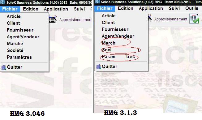

Dear Rathi,
Many thanks you for upgraded version
I'm now with 3.046 version but when i recompile my programs with 3.1.3 version i have the following result
what i must add in my main prg (i use french language)
foued
Re: HMG 3.1.3 (Test)
Posted: Thu May 09, 2013 4:48 pm
Dear Foued, are you using UTF-8 mode in your Code-editor ? If you are using Notepad++, please note you have to change enconding options to UTF-8 and then correct all french words wroten before in ANSI mode in all your source codes.

by fouednoomen
Many thanks Pablo
