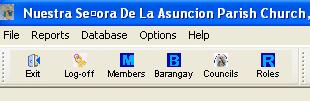

After rebuilding my app using HMG 3.1.2 the windows title becomes like the attached file but it should read as "Nuestra Señora". The character "ñ" is substituted. There is no extra processing done on the win title, just a simple assignment only. e.g. wMainForm.Title := "Nuestra Señora".
Is this from harbour or from HMG? It looks like that it becomes unicode. Is there any switch or options to force ANSI on the apps or shall I fallback to HMG 3.0.46 in this regards?
I use to build the app using HB-IDE and the -w2 option mentioned in one of the Unicode threads can it be set through HB-IDE or I needed a customized batch file to do that?

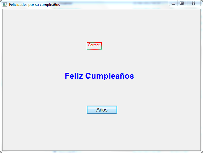

Re: HMG 3.1.2 (Test)
Hola Claudio y Rathi :
descargue la nueva version al leer el comentario de dhaine_adp me puse hacer un pequeño ejemplo, trabajo con Crimson editor
ajusto 'Document', 'Encoding Type = UTF8 w/o BOM' y escribo el Main.Prg
con el IDE creo el formulario que contiene un text y un boton.
este boton cambia el titulo del formulario, caption del boton y valor del label .
al hacer click la funcion cambia estas propiedades y se muestra correctamente las 'ñ?
Translate google
Hello Claudio and Rathi:
Download the new version to read the comments of dhaine_adp do I set a small example, work with Crimson editor
I set 'Document', 'Encoding Type = UTF8 w / o BOM' and write the Main.prg
with IDE created the form that contains a text and a button.
This button changes the title of the form, the button caption label and value.
Clicking these properties changes the function and display correctly the 'ñ'

Function ChangeTitle()
Setproperty( 'Unicode' , 'Title' , 'Felicidades por su cumpleaños' )
Setproperty( 'Unicode' , 'Button_1', 'Caption' , 'Años' )
Setproperty( 'Unicode' , 'Label_1' , 'Value' , 'Feliz Cumpleaños' )
Return*´¨)

- dhaine_adp
- Posts: 457
Hi Rathi and all,
I've already resolved my problem. The problem is from my source code editor setting. I switch the encoding type to UTF-8 w/o BOM, then from windows charmap I set the encoding type to "Unicode" and copy paste the character "ñ" to the source on Crimson Editor to overwrite the old encoding. Now it's working fine.
Well sometimes common sense is not so common.
because I used ASCII encoding on Crimson Editor before and this version is UTF-8.
See attached:
Moving app to UTF-8 is a good start, but I don't know yet if it would affect the dbf file encoding. Now, how can we detect the encoding type of character streams assuming we have no idea?
