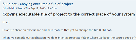

Time ago I presented a solution to the Build.bat carry an extra copy of executable recent file generated, which automatically would make the updating in a different folder where the system runs.
But today I found a hbc directives that Harbour performs the same function. :oops:
I decided to publish and keep you informed because I was unaware and unfortunately no one was interested or did not comment on the existence of this resource. :|

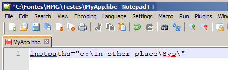

    This instpaths="c:\In other place\Sys\" Harbour directive will make a copy of executable file (in this case MyApp.exe) to the a second place (in this case at "c:\In other place\Sys" subfolder).
  • At Prompt of line command (thru Build.bat)
    You will need to edit <Project_name>.hbc file and add this:

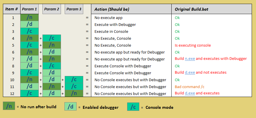

Hi Claudio,
I usually work almost always with IDE to compile my applications. But we know that the IDE uses the same batch file: Build.bat.
And I did some command-line testing with simple GUI and Console applications. I tried all possible possibilities and encountered some bugs in running Build.bat. :|
We have the parameters (for some time already):
/N No run after build
/D Enabled debugger
/C Console mode
And its syntax:
BUILD [/n] [/d] [/c] [<Program.prg>|<Project.hbp>] [<HBMK2 parameters...>]
  • 1st question: I want to know if Build.bat should accept or not, the combination of parameters [/n] [/d] [/c] ?
    I have prepared this table for appreciation and evaluation of what is working and what is not:
    Original Build_bat.png (34.69 KiB) Viewed 9624 times
    Anyone can check and notify us of the bug ...
    Here is my second and third questions below, case Build.bat should accept the combination of these parameters (in my opinion should rather accept), especially the console and not run (I used a lot of it). Because we often do not want the run the generated application where is in the project folder. We only want to run in the folder of user system.
  • 2nd and 3rd questions: Do you agree with the "Action (Should be)" column of the image ? Is it correct in the intended action ?
Please note items 7, 9 and 12 that generate an executable file with the name of one of the parameters. This has to be corrected as well as items 5 and 11.
I need your confirmation to proceed to improve and leave it error free with your usual supervision, of course.
Re: Build.bat
Pablo,
I do not remember at this time the exact content of the build.bat file, but if the parameters are placed in the order defined in the documentation should work correctly.
Build.bat
srvet_claudio wrote:I do not remember at this time the exact content of the build.bat file
I have all most of HMG version installed at my old PC and the sequence is build [ /n ] [ /d ] [ /c ] in this order since Harbour has changed (compiling mode/config, mainly) .
srvet_claudio wrote:but if the parameters are placed in the order defined in the documentation should work correctly
So, you mean that it should be not acceptable inverted order or random order switches like as items 5, 7, 9, 11 and 12 (according my table available in my previous post) ? Please confirm this.
Because today, anyone can do the tests in the sequence described in this table and see what in fact is happening.
IMO, in these cases of errors, Build.bat could check the wrong sequence of switches, interrupt the building and display a warning message to the user.
Because some cases the compilation is effective but with the filename totally wrong and even more is executed when not expected... :?
