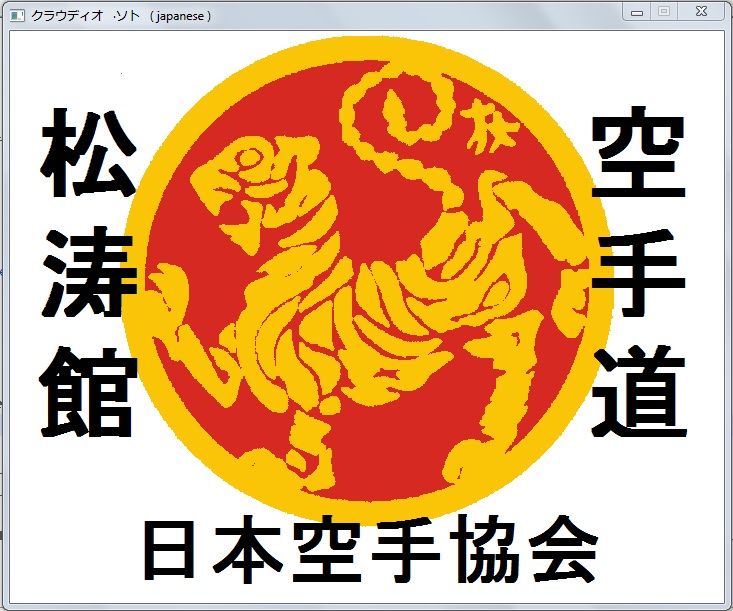

This a very simple example in Unicode (in japanese), but it generates a question: what are the functions in Harbour that support strings in UTF-8 to PRG level?, someone could list?
See the HMG_LEN and HMG_SUBSTR functions in the source code.
Best regards,
Claudio.
Best regards,
Claudio.
- _Shotokan.rar
- (93.72 KiB) Downloaded 532 times
- Captura_Shotokan.jpg (153.16 KiB) Viewed 14592 times
