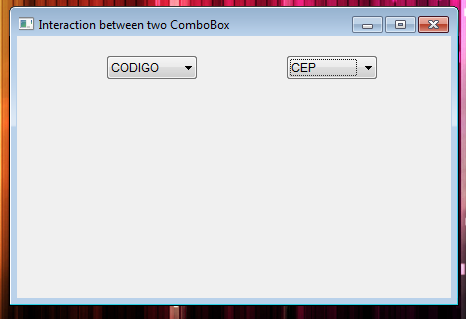

Re: Items en un ComboBox
Posted: Wed Jul 04, 2012 10:37 pm
Hola Rafael
Could you try this too,
I hope will be useful for your need. :)
Interaction between two combobox; screen shoot
CBX2.zip
Interaction between two combobox; .hbp & .prg
(847 Bytes) Downloaded 328 times
