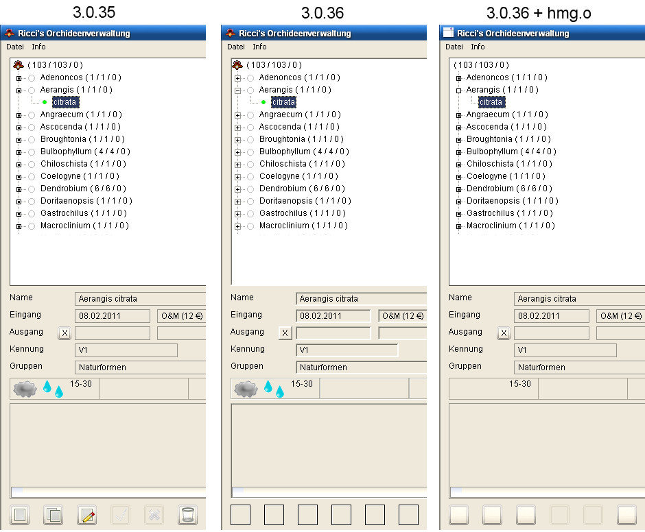

l3whmg wrote:But I have a question for you: when I create my programs, I add my images and for this reason I must compile resource file.
As Rathinagiri wrote in the other thread it is enough to put the resource file name in your project.hbp file.
l3whmg wrote:Adding the file hmg.o to the hmg.hbc, is there some risk (ie duplicating the images distributed by HMG)?
I lost all of my icons in the rc-file.
It´s getting worse ;)

Ricci wrote:Well Grigory, good to have the "flat" design back, but .... all my icons inside the program are gone :(
Hi Ricci,
You are right!
I've changed a file hmg\hmg.hbc to
incpaths=include
libpaths=lib
incpaths=\hmg\include
libpaths=\hmg\lib
libs=hbmzip.hbc
libs=hbwin.hbc
libs=${hb_name}${__HB_DYN__}
libs=hbct.hbc
gui=yes
{win}sources=${hb_curdir}_temp.o
and add to the file hmg\buildapp.bat the following strings:
@echo off
SET HMGPATH=c:\hmg
echo #define HMGRPATH %HmgPath%\RESOURCES > _hmg_resconfig.h
COPY /b %HMGPATH%\resources\hmg.rc+%~n1.rc+%HMGPATH%\resources\filler _temp.rc >NUL
windres -i _temp.rc -o _temp.o
HBMK2 -gtgui %1 %2 %3 %4 %5 %6 %7 %8 -i%hmgpath%\include -lmsvfw32 -lvfw32 -run
del _hmg_resconfig.h
del _temp.*
The result is: main demo have a themed look and custom resources both.
Hope that helps :idea:
Ricci
Posts: 255
Re: HMG 3.0.36 (Test 2011-03-22)
Post by Ricci »
gfilatov wrote:Hope that helps :idea:
Grigory, you are the real HMG wizard !
Thank you, all problems are solved ( whatever you have done ;) ).

Luigi, maybe yours worked because you didn´t use the standard build-files from the 3.0.36 download?
If you download and install the version in a new dir and compile the main.demo you will see no grafic on the two buttons and you have the 3D design.
