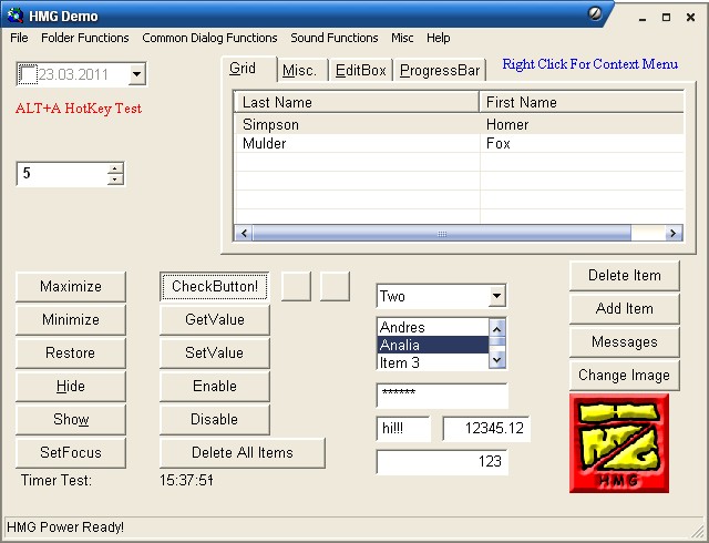

Well, that was from my own program. But whatever sample I take (MAIN.DEMO), buttons are always empty. Strange.rathinagiri wrote:Can you please tell me which sample is this?
In 3.35 it works well. I have Win XP SP3.
- hmg_36.jpg (78.36 KiB) Viewed 7985 times
