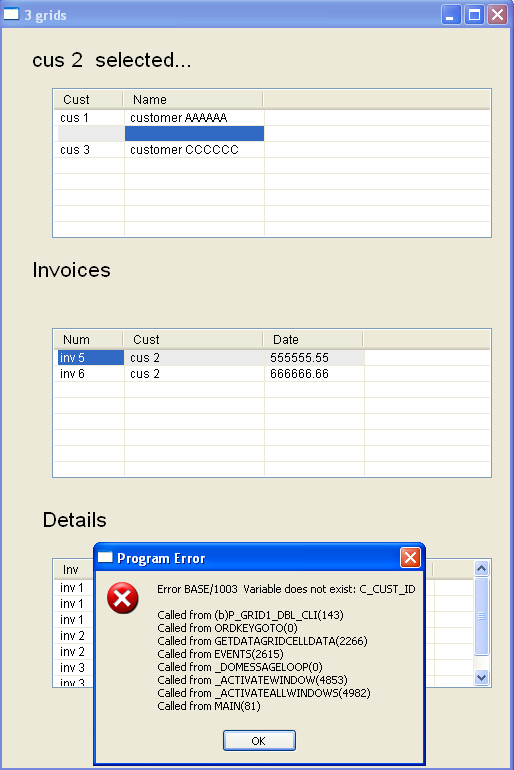

mexicanto wrote:a very beginner questions...
Here's my miserable attempt to help you, in vain :cry:
I've try to solve this problem using 'set filter to', alas...
The error was raised when I've moved the cursor over the grid_2 - suddenly the procedure for the double-click for the grid_1 has been triggered...
Because the major forces of the crowd from here are on the front of HMG4, I know the help in this particular problem is very unlikely - c'est la vie...
The screen with the error - to raise this: 1) select the customer from the Grid_1, then  2) move the cursor over Grid_2...
