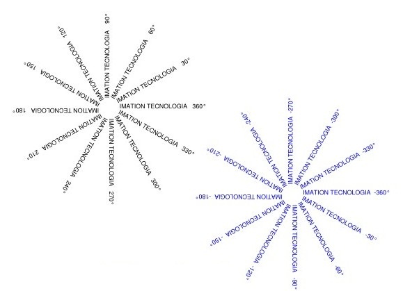

FYI :
I guess you are talking about something like this :
Rotated print sample
RotatedPrint (MR-Print).jpg (42.92 KiB) Viewed 3611 times
If so, you may want look at here.
Re: Como imprimir textos con orientacion diferente
Hello Mr. Esgici,
It looks great but I can not understand programming friend Rolando !!!
And I can not run the demo :(
greetings :)
