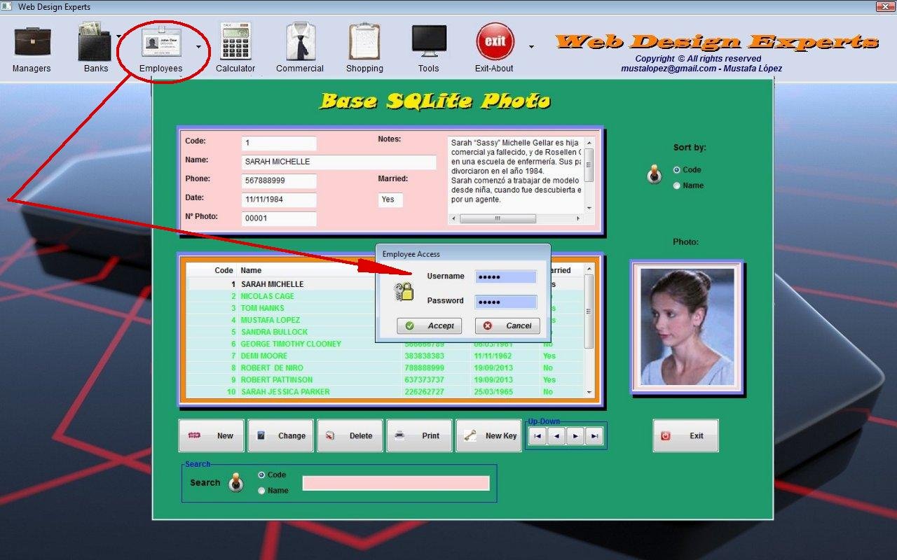

Hello friends :
I want to introduce a humble working with Sqlite database that one day began the
Sudip friends , Rathinagiri , Amarante , Fouednoomen , Qatan , Claudiotedesco
I have based example Claudiotedesco initiated .
I present a data base where we can make New , Change, Delete
Do Search by Code or by Name and according to the Search
We can draw two Listings one ordered by Code or Name
The idea ,is that the user can see all sides of a Database
complement is also the option of placing a Photo.
New: Password which is encrypted in a memo field
admin admin is the Key , if you forget the key to delete the file 'xControl.mem'
a new password will be generated with admin, admin
In a backup folder backup_files ' Zip_Seg.Zip ' will be done with the database
and another file ' Zip_Seg.md5 ' with a code so 7f75d8c703158f135806882e6e9b6064
when you start the application compares if the Zip_Seg.Zip has been tampered with
or missing some file .
I pray consult all entries that accompany them, so if you want to experience
with the true masters of SQlite
viewtopic.php?f=6&t=1558" onclick="window.open(this.href);return false;" onclick="window.open(this.href);return false;
viewtopic.php?f=15&t=853" onclick="window.open(this.href);return false;" onclick="window.open(this.href);return false;
viewtopic.php?f=10&t=2112" onclick="window.open(this.href);return false;" onclick="window.open(this.href);return false;
viewtopic.php?f=12&t=3430&p=31524#p31524" onclick="window.open(this.href);return false;" onclick="window.open(this.href);return false;
viewtopic.php?f=5&t=2951" onclick="window.open(this.href);return false;" onclick="window.open(this.href);return false;
viewtopic.php?f=37&t=2275&p=32226#p32226" onclick="window.open(this.href);return false;" onclick="window.open(this.href);return false;

How do you store the pictures?

Hola Maestro Rathinagiri
Mire por Favor el Fichero Main_SQlite.Prg
Para New en
Function vnombre_baceptar_action()
entramos el valor de Win_1.text_5.value en
c2sql("Photo\"+Win_1.text_5.value+".jpg")+")")
y en Grid ONCHANGE vnombre_grid_1_onchange()
Function vnombre_grid_1_onchange()
Win_1.ImagePhoto.Picture := ("Photo\"+ SUBSTR( aline[7],7,5)+".jpg")
a lo mejor no es muy correcto, pero asi veo que funciona
un saludo
