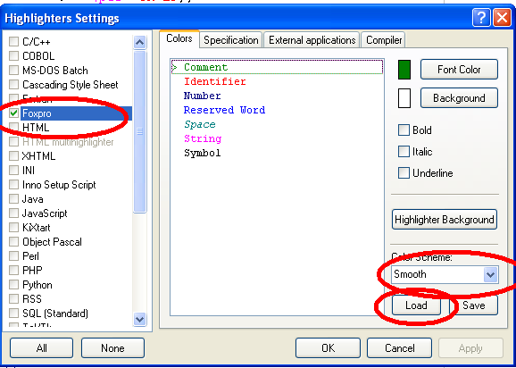

Hi, all
Could some one, post the Pspad syntax files for Hmg.
Ed

- Czarny_Pijar
- Posts: 172
- Joined: Thu Mar 18, 2010 11:31 pm
- Location: 19.2341 E 50.2267 N
Re: HMG 3.0.35
Check this:Steed wrote:Could some one, post the Pspad syntax files for Hmg.
- pspad.PNG (28.37 KiB) Viewed 6705 times

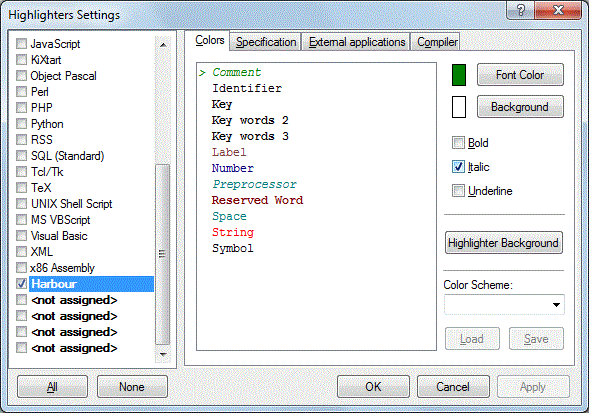

Re: HMG 3.0.35
Thanks,
I just thought, that we have our own style for hmg: including hmg commands.
Ed
Ed
Re: HMG 3.0.35
Hello,
You may try: Please download from I made minor customization for HMG.
