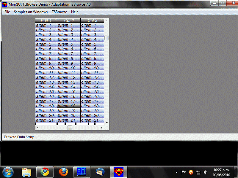

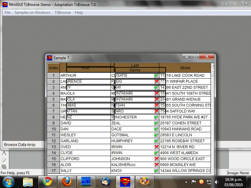

1. When changing column width using mouse, vertical bars stays in the bottom of TBROWSE window (it arises in various samples). 2. In sample 7 (browse on window) when clicking cells a cell frame is drawn at a position different from the clicked cell one (upper left): 3. Moving mouse pointer over headers, cursor flicks.

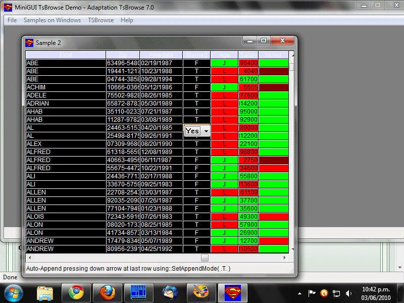

5. Combo does not match cell height in sample 2 (window): 6. In super columns sample, when you attempt to drag the 'January' column, the four arrows pointer is shown, but the column can´t be dragged.

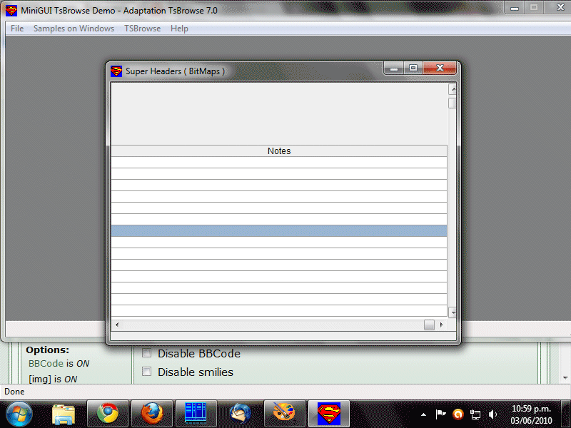

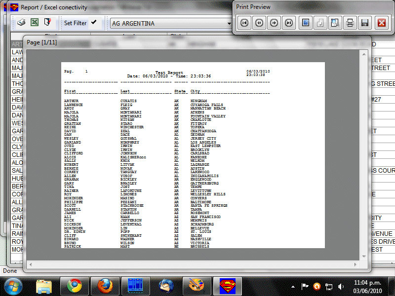

7. In super headers (bitmaps) sample, if you go to the last column and click the horizontal scrollbar (the space between bar left arrow and bar button) you will not be able to scroll to the left. 8. Report / Excel connectivity present (apparently) a problem with the paper size and/or orientation: 9. I've got randomly (or via an undiscovered steps sequence) the following error:

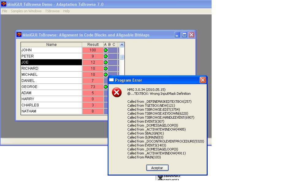

10. I've got some errors on editing:
Error BASE/1004 No exported method: EVALI've tested with HMG 3.0.34 on Windows 7.@...TEXTBOX: Wrong InputMask Definition

Other error on the demos to edit the cell "NAME":
- error.JPG (71.31 KiB) Viewed 8166 times
