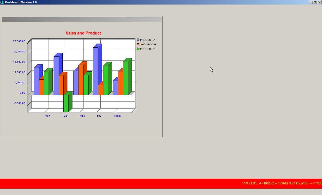

Thanks; but ...
how I can see "scrolling label" ? :(
Re: Problem with prototype KPI - Dashboard Created in HMG
When you maximize the main window, you can see the scrolling label. Isn't it?
rathinagiri wrote:When you maximize the main window, you can see the scrolling label. Isn't it?
Yes, it is ;)
But how under nosize nosysmenu :?:
Even Alt-Enter doesn't work :(
You can't maximize the graph window. But the window behind it. As I had said, to avoid the flickering effect, both graph and label should be shown in different windows.

Regarding the flickering effect, if we can draw the graph in a separate window that will not be repainted when the text is scrolled.

I downloaded the revision you made. But I already thought of that direction after I made my posting. However your suggestion confirms that solution and I really appreciated your time and effort. Also thank you for fixing the graph display. That one really puzzled me. Great! You fixed that problem.
But honestly, I thought it can be done in one window.

Perhaps adding transparency in the graph window will add some more effect. Anyway, it seems that it can be accomplished with lot of codes to handle the different graphs to display them simultaneosly. If there are four graphs that means four updates. Well it's not bad at all. The most important thing is that it is possible and it can be done.
Yes. We can do this Danny. We have to give the 4 co-ordinates to redraw the window. Other parts of the window would not be re-painted. So, there won't be any flickering.

rathinagiri wrote: You can't maximize the graph window. But the window behind it. As I had said, to avoid the flickering effect, both graph and label should be shown in different windows.
Sorry Rathi;
I have missed separate window concept :(
