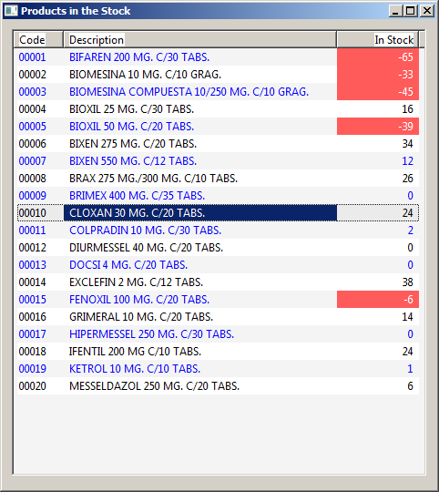

The DynamicBackColor in third column of the browser, expects a block which returns an array of color codes. You have given block which returns again a block instead of an array of color codes. ie., you have nested two blocks which is an error here.

rathinagiri wrote:
DYNAMICBACKCOLOR { bckColor, bckColor, { || If( g_existotal < 0, { 255,   0,   0 }, If( RecNo() % 2 == 0, { 255,255,255 } , { 244,244,244 } ) ) } }	;
DYNAMICFORECOLOR { bckFore , bckFore , { || If( g_existotal < 0, { 255, 255, 255 }, {0,0,0}  ) } } ;

Re: Forecolor in grid displays the records alternating color
Czarny_Pijar wrote:
rathinagiri wrote:
jparada wrote:Hi,
After getting that negative numbers are deployed with the color red (Thanks again Roberto).
Now I also like to do the same with DynamicBackColor property, and I try to do exactly as I do with the property DynamicForeColor, but I could not do it.
I attached image about the error that I am getting, please take a look, and also attach a small example, please take a look too.
Please can someone tell me how to fix it?
Thanks
Best Regards
Javier
Hi Javier,
Change the two lines (33,34) with this...
I think that is an important example, and it should be placed in the Samples.
How about a missing Grid.13 ?
I made some corrections, some are for Grid propose and others which have not working.
GRID_13.rar
Source files
(3.32 KiB) Downloaded 188 times
