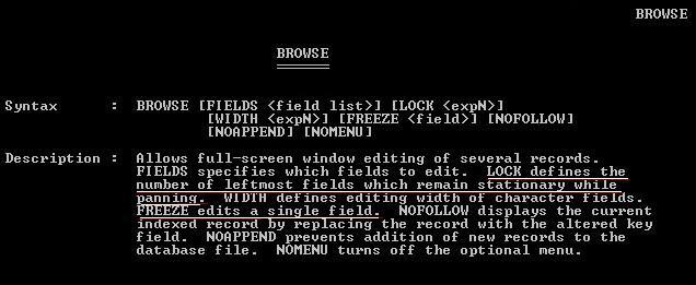

esgici wrote:Yes, everything is OK for me too :D
Tested, LOCKCOLUMNS with values other than 1 (even less than 1 and greater than column counts !), and applied some previous GRID samples; no problem seen :D
By the way, this was LOCK or FREEZE ? It seem to me in old days ( happy dBase and Clipper days ;) ) these was two separate process.
Now, we need waiting test results by Marek ;)
Best regards and hearty thanks Roberto :D
I've was a FoxPro programmer. In FoxPro, FREEZE has a different meaning. This is the reason my choice was LockColumns.
Re: I had an epiphany (another boring story :)
esgici wrote:Your are working for us even in your relax time :)
Oh nooo... do HMG is relaxing for me :)
Roberto Lopez wrote: ...
Your choice and implementation is exactly compatible with dBase too :D
Help page for BROWSE of dBase
"Boring story" is the mine, your work is excellent as always :)
Best regards and thanks again
