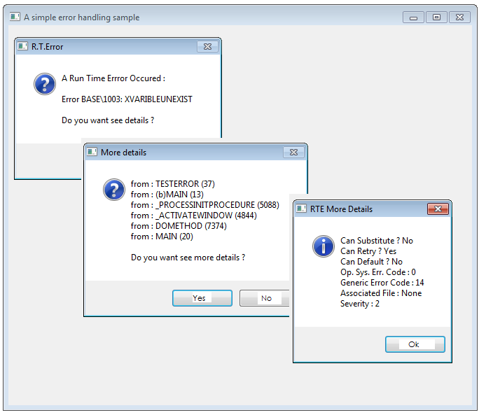

Rossine wrote: It would be possible to assemble a complete example to demonstrate this new method using error control and the old ?
Sorry, I don't understand, what are new and old. :?:
But what I'll work to offer an example. Not complete, but a simple and working sample.
Simple Error Handle Screen shoots
SErrHandle.zip
Simple Error Handle .prg & .hbp files
(1.51 KiB) Downloaded 369 times

Hi Esgici,
Wow :D
esgici wrote:Ciao Rossine
SErrHandle.zip
Excellent example. I will implement this in my error handler,
Thank you very much,
Rossine.

Hello Rossine !
Adding a case for study:
Bellow a nice and complete error Handler for CUI mode (Console)
Can be adapted to any Gui Lib...
just use the source on contrib
\Harbour\contrib\xhb\xhberr.prg
Some years ago I have adapted this with some more info about my systems and sending error report via e-mail...
Then made possible to fix many errors or provide other solution before users phone call's ;)
M., Ronaldo
By: IMATECH
Imation Tecnologia
