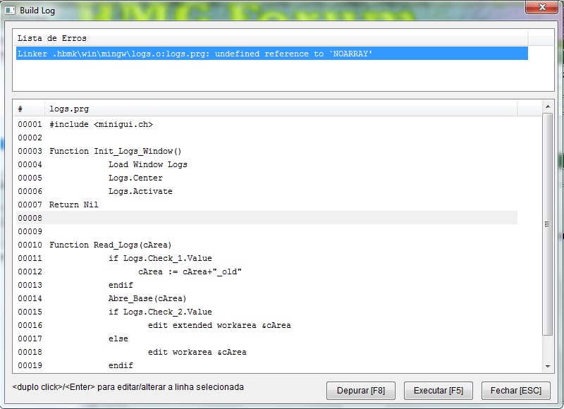

I try recompile one project my on this new version of HMG, but i´ve a message like this "Undefined Reference to 'NOARRAY' ". Please, see the image bellow.
I posted the source code too.
What happen? Where be my mistake?
PS: Sorry my bad english

- Roberto Lopez
- HMG Founder
- Posts: 4023
Re: HMG 3.0 FORUM TEST XVII
It's my fault.Vanguarda wrote:Hi All,
My friends,
I've erroneously deleted such function present in previous releases. It is used by EDIT command.
Function NoArray (OldArray)
Local NewArray := {}
Local i
If ValType ( OldArray ) == 'U'
ELse
Asize ( NewArray , Len (OldArray) )
EndIf
For i := 1 To Len ( OldArray )
If OldArray [i] == .t.
NewArray [i] := .f.
Else
NewArray [i] := .t.
EndIf
Next i
Return NewArray
