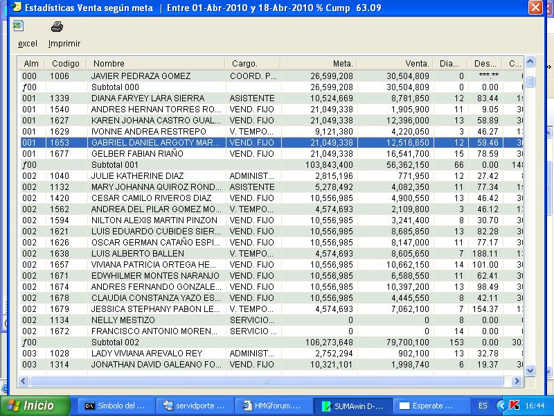

Frecuentemente se usan grids mostrar datos de una dbf con totales,
pero si se elimina una de las filas, los totales quedan desactualizados
seria posible incluir un evento " ON DELETE " o sea la funcion que deba ejecutar cuando se elimina un registro
gracias
Juan carlos Escobar
Bogota, colombia
GRID CON TOTALES.JPG (152.8 KiB) Viewed 2005 times

Hola Juan Carlos
Did you checked your SET DELETED ON / OFF ?
If you have set it OFF, (or not set, because default value is OFF); this behavior is normal. For expected result, you have SET it ON.
If you have already set ON, in that case we have another problem.

All Grid operations are BUFFERED, so when you delete a record, it is not really deleted until you save pending changes.
If you want a special treatment at save time, you must use OnSave event and handle disk updates yourself (look at \samples\grid.34).
