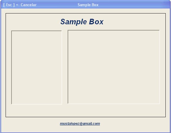

Hola Mustafamustafa wrote:Another trick for the ornaments
Congrats, you ( or your friend Lucho Miranda ) had exposed two undocumented HMG features: BORDER and CLIENTEDGE properties of LABEL
But I'm a little confused
First I added this lines to your x named window:
@ 80, 80 LABEL lblOverlap VALUE "Overlapped" AUTOSIZE ACTION MsgBox( "Overlapped LABEL clicked" )
@ 120, 80 BUTTON btnOverlap CAPTION "Overlapped" ACTION MsgBox( "Overlapped BUTTON clicked" )
@ 160, 40 TEXTBOX txbOverlap WIDTH 150 VALUE "Overlapped TEXTBOX" Second commented
x.BOX_IN00.Enabled := .F.If possible, could you give a bit explication on your ornament trick please ?

Re: GIF animation demo
Hello Esgici
Just this routine gave me the friend Lucho Miranda
I'm only used to make ornaments, I can not explain much
composition because I restricted myself to using it.
To see more of the routine operation of the Post looks
http://hmgforum.com/viewtopic.php?f=9&t=1059 ---> Remember.exe
Put on x.BOX_IN02.Enabled: =. F. or x.BOX_IN02.Enabled: =. T.
Guess it's a Failure, but the end of the routine is to make
Decorative Programs.
Greetings
Hello Esgici
I've discovered that you need
I've given two examples in one calendar and not let TexBox write
or turn the calendar and the other if it is on. F. if you can handle.
Regarding Lucho Miranda nick "ELSalmes" is often collaborate in Forums in
Http://es.groups.yahoo.com/group/harbourminigui_es/ and Spanish from
http://es.groups.yahoo.com/group/oohg/ forum, I know because
not participating in our forum HMG would be a great contribution.
Greetings
