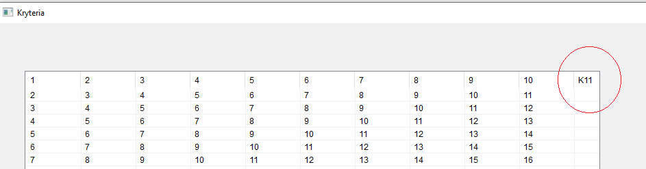

But the texts in the last column do not appear. Any idea ? Help me please.
Re: AddColumn to GRID not working properly
Do you K11 column. This is working with HMG3.6
See att.

I have this column. You are right. But column data are empty. This is that problem - column data are empty
try this:
   FOR i := 1 TO nWiersze
	   //kryteria.Grid_1.CellEx (nKolumnyNowe, i) := "New text"
      SetProperty('kryteria', 'Grid_1', 'CellEx', i,nKolumnyNowe , "New text" )
This fills up the grid
kjedroska
Posts: 6
Joined: Fri Jan 10, 2025 10:48 pm
Post by kjedroska »
WORKS !!! THX
