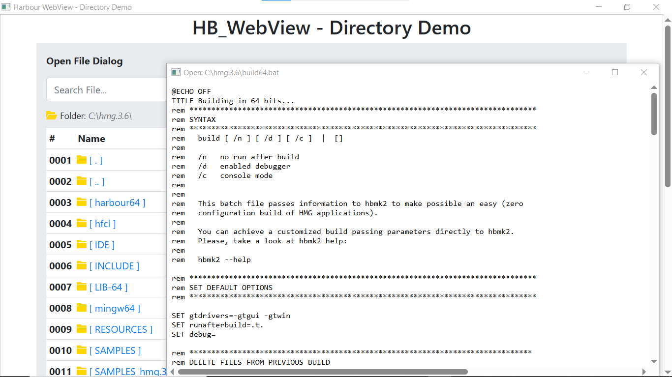

Hi all,
I've added a new demo.
demo6.prg: You can navigate the directory tree and open files that are in the list of allowed extensions (new instances of HB_WebView are created entirely from Javascript code).

Claudio,
Demo6 - function sortTable( cID, n )
There is some strange sorting going on when sorting on NAME.
DATE is perfect.

Hi Serge,
It must be because when sorting by name it is actually sorted by (attribute + name), it must be some attribute not considered.
Please run the following function with the problematic path and email me the resulting file: file_list.txt
Tell me the name of the problematic file.
