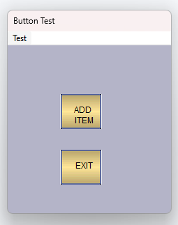

Here is code and picture.
I will add code for making image picture.
Screenshot 2024-12-10 092930.png (9.16 KiB) Viewed 1504 times

In the above code the image size sets the size and text of the label
