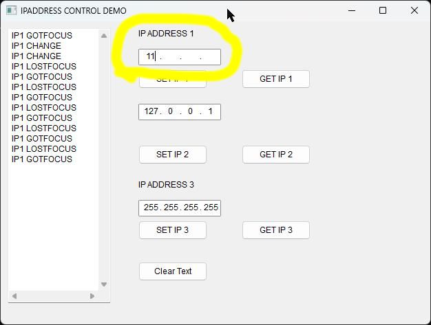

Estoy trabajando por primera vez con el control ipadrress, cuando inicio el control todo bien, pero si trato de ingresar una direccion solo me permite 2 digitos de los 3 que necesito, anexo un ejemplo
Agradezco de antemano culquier apoyo
I am working for the first time with the ipadress control, when I start the control everything is fine, but if I try to enter an address it only allows me 2 digits of the 3 that I need, I attach an example
I thank you in advance for any support

Hello Martingz,
I confirm this strange behavior of the sample in the folder
c:\hmg.3.4.4\SAMPLES\Controls\IPAddress\IPADDRESS_1
Thanks for your bug report :!:

I left the topic for a bit to clear my head and today I continued with the tests. Everything is fine with the control, except that the default length of the control does not allow you to see or change the 3 digits, it is only an increase of 120 from the default at 140 and it lets us see all the digits
I'm leaving this here in case anyone has the same problem.
