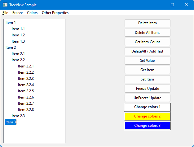

I want to refresh this topic, but my question is a little differnt.
I want to build left side menu based on tree control, but I want the treelines are invisible. Also + and - for expand/collapse tree should be invisible.
Does anybody have information how to do it?
gfilatov
Posts: 1116
Location: Ukraine
Re: TREE
Post by gfilatov »
mol wrote: Fri Feb 09, 2024 3:10 pm I want to refresh this topic, but my question is a little differnt.
Does anybody information how to do it?
Hi Marek,
Yes, it is possible.
Try to use
HMG_ChangeWindowStyle (Form_1.Tree_1.HANDLE, NIL, TVS_HASBUTTONS, .F.)
HMG_ChangeWindowStyle (Form_1.Tree_1.HANDLE, NIL, TVS_HASLINES, .F.)
See my result in the picture below:
Hope that helps. :idea:
