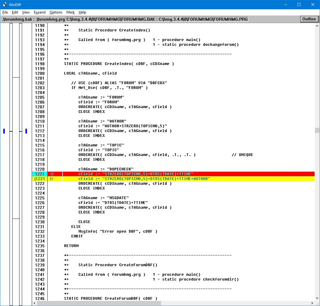

i have enhance Index TAG "DUPECHECK" and add AUTHOR
      cField := "STRZERO(TOPICNO,5)+DTOS(TDATE)+TTIME+AUTHOR"
you also need to edit DLFORUM.PRG and search for
      cSeek := STRZERO( nThreadNo, 5 ) + DTOS( dDATE ) + cTime
and change to
      cSeek := STRZERO( nThreadNo, 5 ) + DTOS( dDATE ) + cTime + cAuthor  // add cAuthor
3 x times
delete old *.CDX before run new CODE
