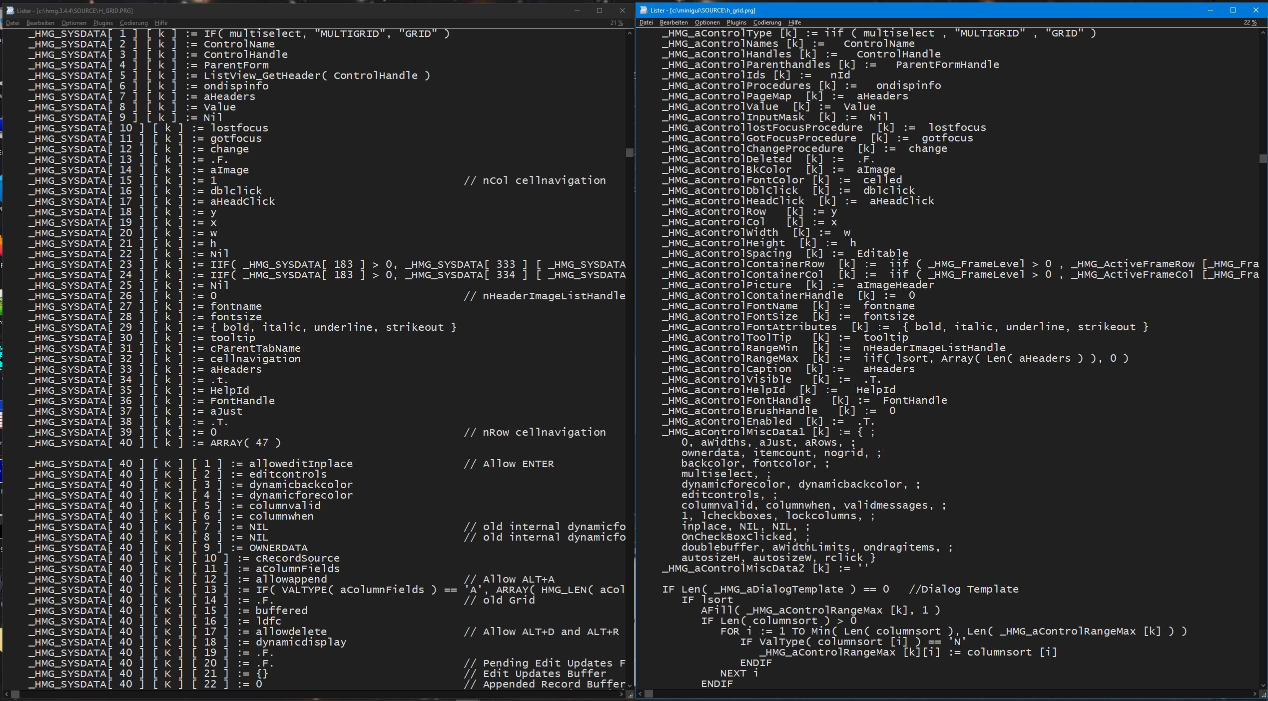

Re: _HMG_SYSDATA
hi Red,
you can compare HMG Source and Extended Version where _HMG_SYSDATA under HMG is (almost) the same like Member (DATA) of Extended Version

Re: _HMG_SYSDATA
hi Red,
sorry, i forgot it are no CLASS CODE where i have DATA
under MiniGUI Extended Version you got _HMG_aControl??? instead of _HMG_SYSDATA [???]
for ??? MiniGUI Extended Version use a Name so you get a Idea what it is for
search for Variable and look where it store in Array
this will work up to _HMG_SYSDATA [40] of each Control ...
also look into INCLUDE\i_altsyntax.ch where you can find some Comment
