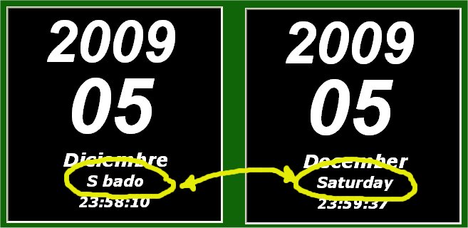

Hola he detectado una cosa rara, estoy usando CDOW (DATE()) para que
me salga el dia de la semana en español y al principio del programa pongo :
REQUEST HB_LANG_ES
HB_LANGSELECT( "ES" )
SET CENTURY ON
SET DATE FRENCH
SET LANGUAGE TO SPANISH
y me está faltando la letra [ a ] --> [SABADO] -- > [S 'a' BADO ] = [ SATURDAY]
No se si en otros idiomas que no sean el Ingles está sucedirendo lo mismo ?
Estoy revisando haber si pasa en otros días de la Semana
Recuerdos
ERROR to see the day of the week CDOW in Spanish
Hello I noticed a strange thing, I'm using CDOW (DATE ()) for I
out the day of the week in Spanish and at first put the program:
REQUEST HB_LANG_ES
HB_LANGSELECT ( "ES")
SET CENTURY ON
DATE SET FRENCH
and he is missing the point [a] --> [SABADO]--- > [S 'a' BADO] = [SATURDAY]
If not in other languages other than English is sucedirendo the same?
I have reviewed if you pass on other days of the week

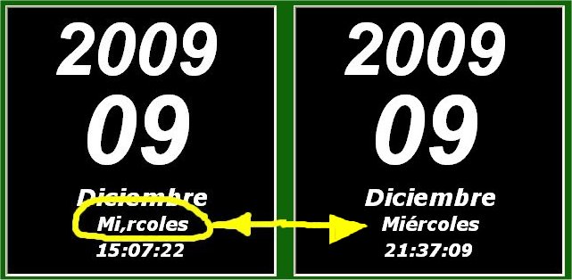

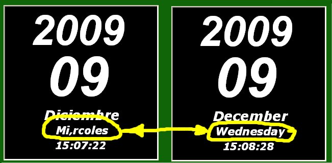

Hola a todos
he encontrado otro error en Wednesday = Miercoles
podria ser el acento ?
Hello everyone
I found another bug in Wednesday = Miercoles
could be the accent ?

Solucionado a mi manera
Sustituyo los dias de la semana en Ingles al Español
Sigo creyendo que el problema son los acentos
Solo hay dos días acentuados Miércoles y Sábado
Fixed it my way
Replace the days of the week in English to Spanish
I still believe that the problem is the accents
Only two days are Wednesday and Saturday accented

mustafa wrote:ERROR al Ver el dia de la Semana CDOW en Español
You must use hb_oemtoansi() function, ie:
hb_oemtoansi(cdow(date()))
http://www.harbour-project.org/doc/hb_oemtoansi.htm
