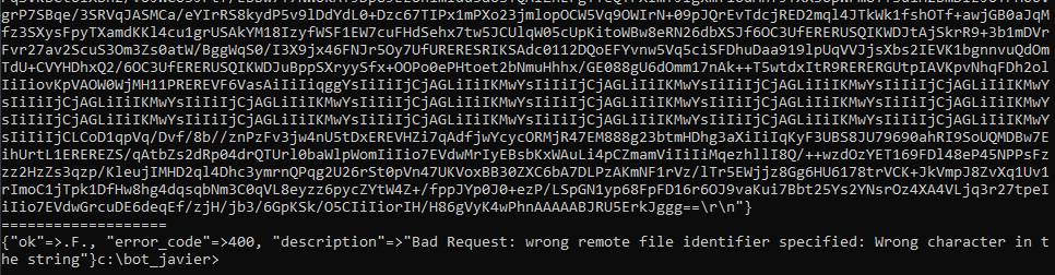

I'm having trouble with the sendPhoto function since as I understand it requires converting the png image file to base64, so I'm trying something like this:
local cImgLocalPath := "c:\bot_javier\image.png"
cImgFileContent := FileStr( cImgLocalPath )
cBase64ContentFile := hb_Base64Encode( cImgFileContent, Len( cImgFileContent ) )
oBot:sendPhoto( chat_id, "caption", cBase64ContentFile, "" )
but I get this error response:
do we have some function to convert the image file to base64?, I'm doing something wrong with?.
I appreciate any help.

Did you check exact error? Wrong remote file identifier specified: Wrong character in the string.
Maybe see: https://github.com/telegraf/telegraf/issues/886
