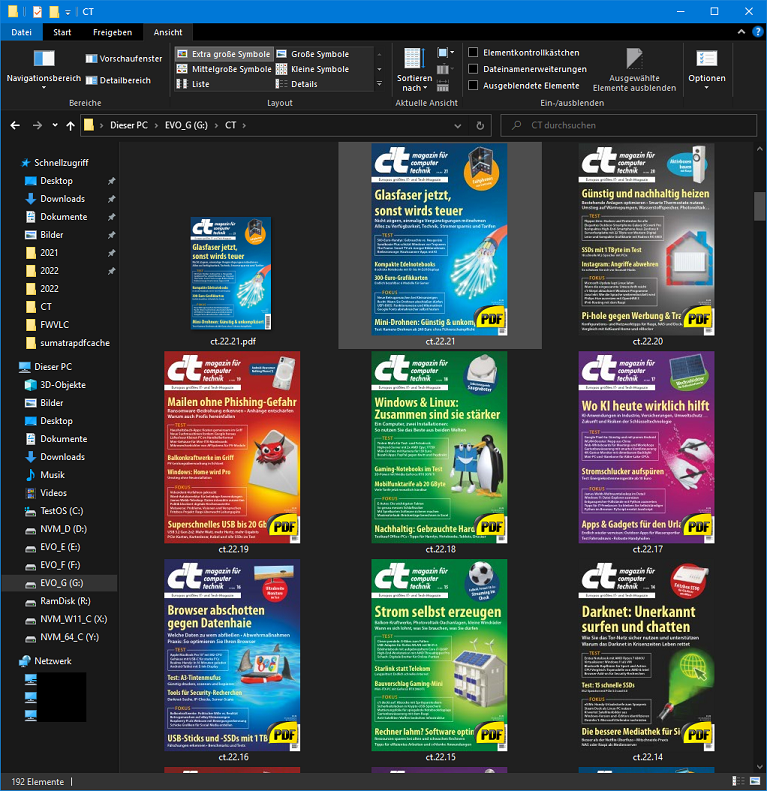

Sample
g:\CT>mutool draw -o "ct.22.22.pdf.png" -r 96 -h 150 "ct.22.22.pdf" 1-1
page ct.22.22.pdf 1
see upper left in Snapshot
