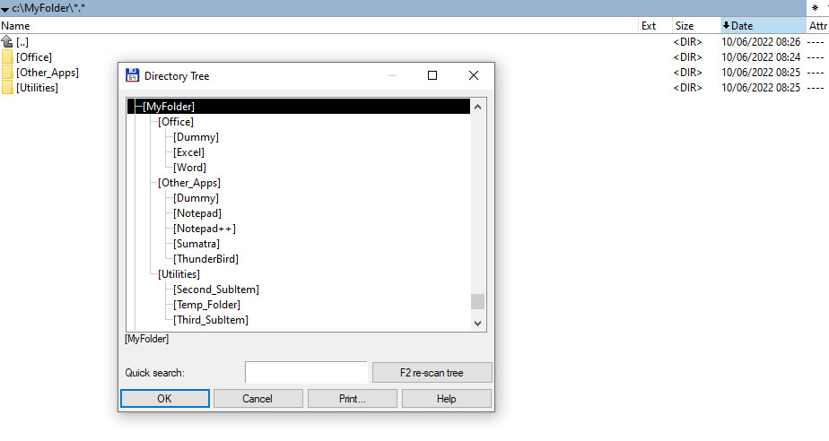

Re: Any samples to retrieve a nested array of folders and files?
If the above nested array in the last post were from a folder, the folder might look something like the attachment.
As mentioned above, I'll post the solution when it's completed.
- MenuFolderStructure.jpg (73.78 KiB) Viewed 8836 times
