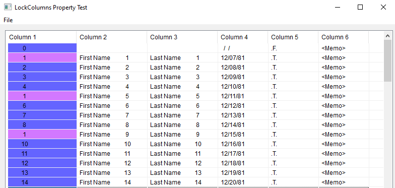

Thanks Gabor, This works but I need it refined.
What I want to do is if field-> value is 1 i want only column1 with color the other columns are black ( this works as a second header
Otherwise all columns are coloured as below but I cannot get if yo work in grid for dynamicbackcolor
public bl
	public blcolor :=   {0,0,0}
	public bcolor  :=   { || if (this.Cellrowindex/2 == int(this.CellRowIndex/2) ,{210,120,255}, {100,100,255})}
if field->code == 1
bl := .t.
bl := .f.
 IN GRID
if bl = .t.
			dynamicbackcolor{ bcolor,blcolor,blcolor,blcolor,blcolor,blcolor}
			dynamicbackcolor{bcolor,bcolor,bcolor,bcolor,bcolor,bcolor}

Hi Franco,
Maybe I don't understand what you want.
If the value of the field is 1 in the first column, should the entire column be colored and not just the given cell?
Or is that what you meant?

Yes Gabor, what I want is this but, also the other rows tow different colors.
{ || if (this.Cellrowindex/2 == int(this.CellRowIndex/2) ,{210,120,255}, {100,100,255})} but if any grid field = 1 its pink.

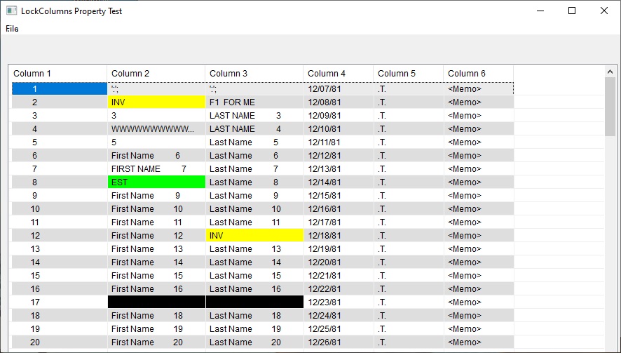

I want to thank everyone for help.
This is what I ended up with and works great.
Each cell has a code EST for estimate or INV for invoice, or nothing for non recorded schedule.
The black separates the the days.
I built this using grid28 in samples.
Local aValue := { Nil , Nil }
PUBLIC b1Color :=  { || if ( This.CellRowIndex/2 == int(This.CellRowIndex/2) , { 222,222,222 } , { 255,255,255 } )}
 PUBLIC b2Color := { || If( AtCellCol(2)=="':';", BLACK , ;
                        If( AtCellCol(2)="INV",YELLOW, ;
			if( AtCellCol(2)="EST",GREEN, ;
			If( This.CellRowIndex/2 == int(This.CellRowIndex/2) , {222,222,222} , ;
				{ 255,255,255})))) }
 PUBLIC b3Color := { || If( AtCellCol(3)=="':';", BLACK , ;
                        If( AtCellCol(3)="INV",YELLOW, ;
			if( AtCellCol(3)="EST",GREEN, ;
****** In my scheduler all fields are text so it works perfect.
 ****** CAN NOT USE WITH LOGICAL, DATE ,MEMO at this time OK for me.
	DEFINE WINDOW Form_1
	DEFINE GRID Grid_1
			dynamicbackcolor{b1color,b2color,b3color,b1color,b1color,b1color}
		END GRID
Function AtCellCol(nColIndex)
	Local nRowIndex := This.CellRowIndex
	Local nRet := GetProperty( "Form_1", "Grid_1", "CellEx", nRowIndex, nColIndex )
Return nRet
