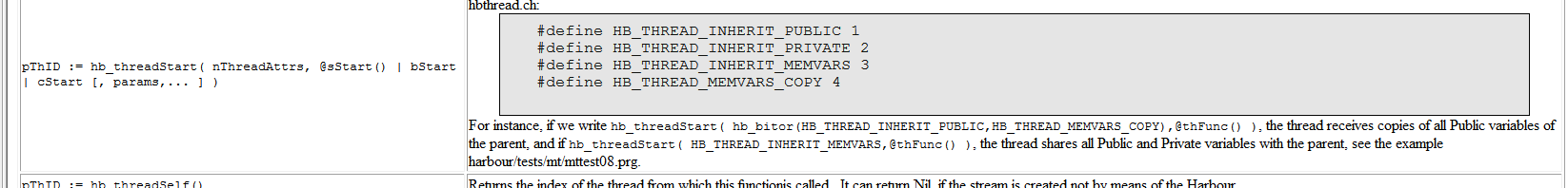

Re: hb_threadStart() and DBF
If every thread has its own world, is the way to return some results from thread?
