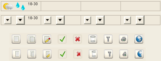

When leaving the program in background, working with Firefox and Thunderbird and going back some of the pictures changed completely oder shift a little bit. Sometimes they repair themselves when using IMAGE, but the BUTTONs remained defect.
Please see the picture attaches to the topic with the before - after effect. The above are IMAGEs the lower are BUTTONs.

Screenshot of the problems

About 3 seconds after the program has started, it gets a repaint from windows (?) and then the first frame disappears. It is always the first FRAME i define, no matter where the DEFINE is positioned in the program. If i repaint the FRAME after it disappears with a
Form_1.pflegerahmen1.Row := Form_1.pflegerahmen1.Row
then it remains on the screen. Funny thing, my workaound is to define a dummy frame before the 4 real frames.

As i thought before, it´s a conflict of the program with the "Winstep Extreme" desktop enhancement ( http://www.winstep.net/ ).
It´s the "Windows peeking" future, that must be disabled for HMG Programs. "Windows peeking" means the desktop enhancement makes a snapshot of every active program from time to time to present them in the tasklist if go with the mouse pointer over it. Some programs didn´t like this.
