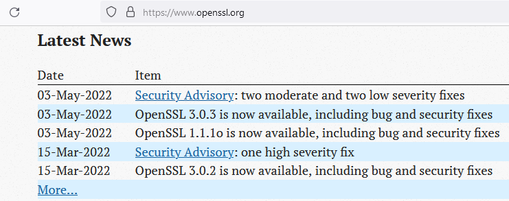

Try https://slproweb.com/products/Win32OpenSSL.html
Note :
2022-05-25 20_57_42-_index.html.png (40.17 KiB) Viewed 2158 times
Re: TLS > v1.1
danielmaximiliano wrote: Wed May 25, 2022 11:59 pm Try https://slproweb.com/products/Win32OpenSSL.html
Note : 2022-05-25 20_57_42-_index.html.png
