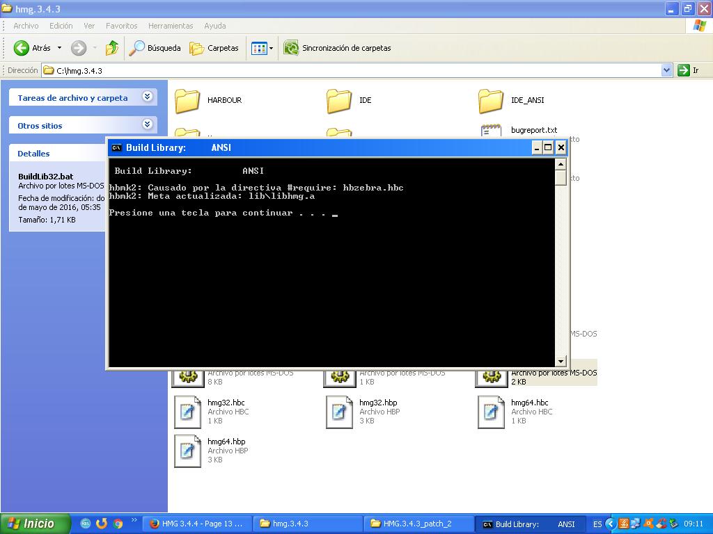

Hola Amigos :
debido a problemas en el comportamiento de HMG.3.4.4 que tengo en mis aplicaciones intento regresar a esta version y me encuentro lo siguiente :
Instalo HMG.3.4.3 , luego instalo el PATCH1 y genera sin problemas la libreria con Buildalllib32.bat .
Ahora cuando instalo el PATCH2 y genero la libreria con BuildAllLib32.bat obtengo el error que adjunto .
No se que puede estar ocurriendo .
Mario Mansilla
Hello friends :
due to problems in the behavior of HMG.3.4.4 that I have in my applications I try to return to this version and I find the following:
I install HMG.3.4.3, then I install the PATCH1 and it generates without problems the library with Buildalllib32.bat.
Now when I install the PATCH2 and generate the library with BuildAllLib32.bat I get the error that I attached.
I do not know what may be happening.
Mario Mansilla
hmg.3.4.3 patch2.JPG (82.88 KiB) Viewed 7894 times

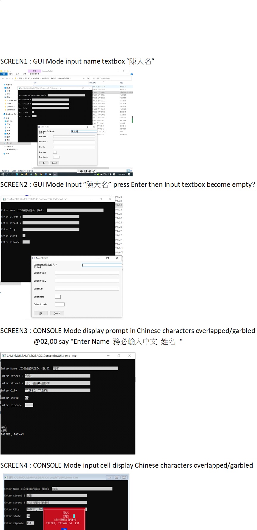

Dear Mr. huiyi_ch,
Console & GUI not support Chinese characters for input and display
1. The cells and textbox are able to input Chinese characters which according to Przemek instruction that syntax had been add correct HVM CP as follows(class get (google.com)).
2. Chinese characters still displayed overlapped/garbled.
3. Przemek mentioned to apply screen refresh code used by GT system and force redrawing will solve the Chinese characters display problems.
4. Would you please kindly teach me how to solve the display problems with the
Sameles located “C:\MiniGUI\SAMPLES\BASIC\ConsoleToGUI”.
Correct HVM CP:
REQUEST HB_CODEPAGE_UTF8 //RBT ADD
request HB_CODEPAGE_BIG5 //RBT ADD
function Main()
hb_cdpSelect( "UTF8" ) //RBT ADD
hb_cdpSelect( "BIG5" ) //RBT ADD
hb_cdpIsCharIdx( "BIG5", .T. ) //RBT ADD
Best Regards,
[image][/image]
