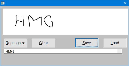

have found other Way.
instead of "save" using IPF_GIF, which is a valid "GIF89a", i use IPF_Base64GIF
now i can simple "load" encode File into INK and "recognize" it :D

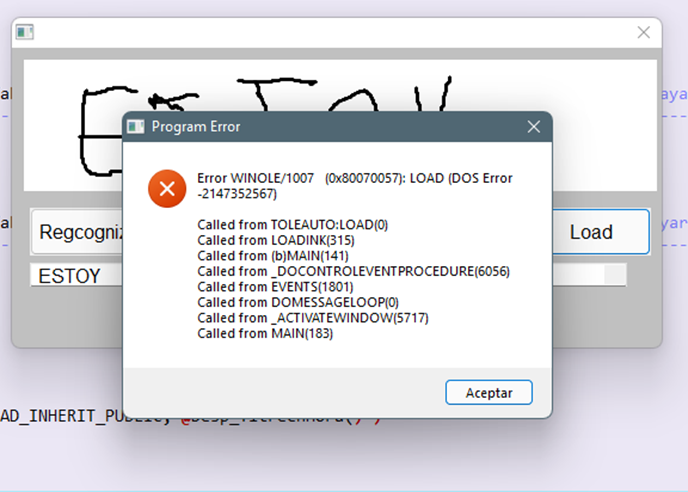

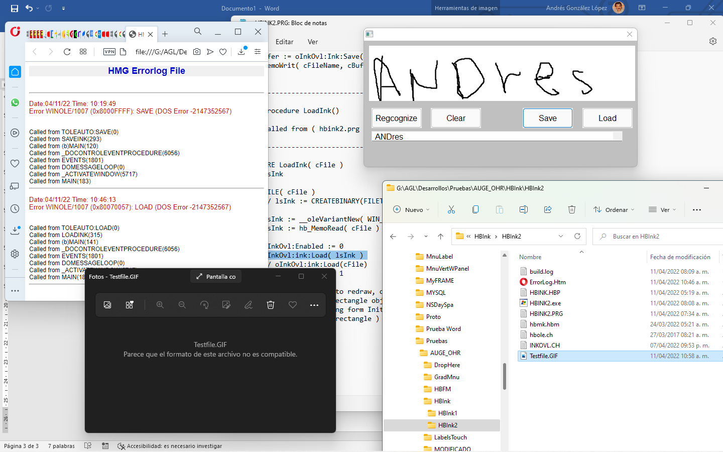

Hola Jimmy
Cuando oprimes "Clear", deja de funcionar...
Hi jimmy
When you press "Clear", it stops working...
P.D.
Te intercambias entre ventanas y funciona de nuevo...
P.S.
You switch between windows and it works again...
Al cargar
To Load...

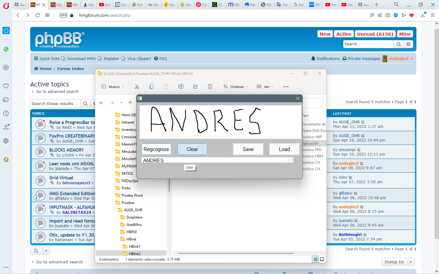

Re: FoxPro CREATEBINARY() how under harbour ?
Algo está pasando.... quizá porque tengo Win11 ?
Something is happening... maybe because I have Win11 ?

hi Andy,
ths for Comment.
i have test it under Windows 11 Version 10.0.22000.593 and DEV 22593.1 without Problem.
i guess you use same "Testfile.GIF" which you have "save" before
! Note : using IPF_Base64GIF does NOT produce "real GIF89a" like using IPF_GIF
so you can´t use a "normal" GIF as i does not include "Metadata" of Strokes
you can "load" File only once and not allowed to "add Stroke"
it will produce Error when try "load" 2nd Time even when have "clear" before ...
Error WINOLE/1007 (0x80070057) LOAD Parameter : [ 1] = C base64 ...
but your Error in 1st Picture point to "DOS Error" ... hm
where can i get more Information about "WinOEK/1007 (-2147352567) :?:
