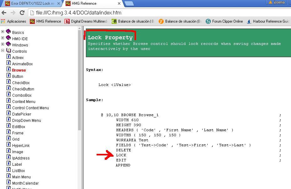

carlazza wrote: Sat Mar 12, 2022 2:40 pm I wrote this post just to ask how to fix the lock problem
Hola amigo, Me refiero si habias probado la CLAUSULA LOCK que tiene la clase browse...., igual ahora me explico mejor

SALINETAS24 wrote: Sat Mar 12, 2022 4:06 pm
Ok Ok amigo.
I've already done it but doesn't work.
Thx
