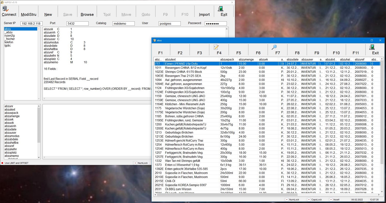

i have begin to re-write my Xbase++ PGU App to harbour HMG
it can (quick) "Import" DBF to PostgreSQL Table
it is special made for Table > 100000 ROW so i use a "virtual" GRID
it is special made for PgDBE Concept of Alaska Xbase++ v2.x which have some "internal" FIELD(s)
   " __deleted    boolean NOT NULL DEFAULT false, "
   " __record     serial  NOT NULL, "
   " __rowversion integer NOT NULL DEFAULT 0, "
   " __keyversion integer NOT NULL DEFAULT 0, "
   " __lock_owner integer NOT NULL DEFAULT 0, "
and use a PRIMARY KEY on __record
   " CONSTRAINT " + cTable + "_pkey PRIMARY KEY (__record)"
i need __record ( => RECNO() ) for "re-position" when change Column in GRID
so it will not work well with "normal" PosgreSQL Table
other "internal" FIELD(s) are for Network
if you are interest "how" it work i will make a new Thread for it
