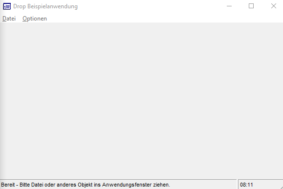

Re: "shell.explorer.2" and "Drop" from Outlook
hi
i have made a Demo EXE Version which will work (or not) without "Check"
"Check" does "only" work with German Message, other Language i can not test
OLRICH.zip
(1.46 MiB) Downloaded 65 times
please use this Demo "only" for Outlook Email :!:
"other" may work .. but it can also crash.
App will display at upper/left and "wait" for "drop"
as it is a "normal" RICHEDITBOX so you can use it in your App without any change
if you like it please post Snapshot of MessageBox for you Language
