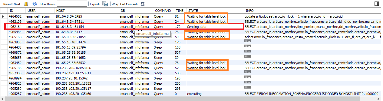

Realicé la consulta con mi proveedor de host y me respondieron que hay actividad inusual en el servidor MySQL y me enviaron esta imagen:
base de datos sleep.jpg (197.34 KiB) Viewed 1842 times

Sin embargo, se me siguen desconectando TODOS los puntos, el MySQL se desconecta y se me cuelgan todas las terminales. Esto ocurre de manera imprevista, puede ocurrir 3 o 4 veces al día.

Thanks so much. Your answer helped me a lot. I found that a specific terminal, for some reason, left a table locked and since I am using MyIsam engine, the rest of the terminals were hung. I could solve it manually by performing a KILL of that process and everything continued normal. I'm going to convert all my tables to InnoDb engine and create a process that "kills" the "Sending Data" connections that are more than 100 seconds long, while identifying the problem of that terminal.
