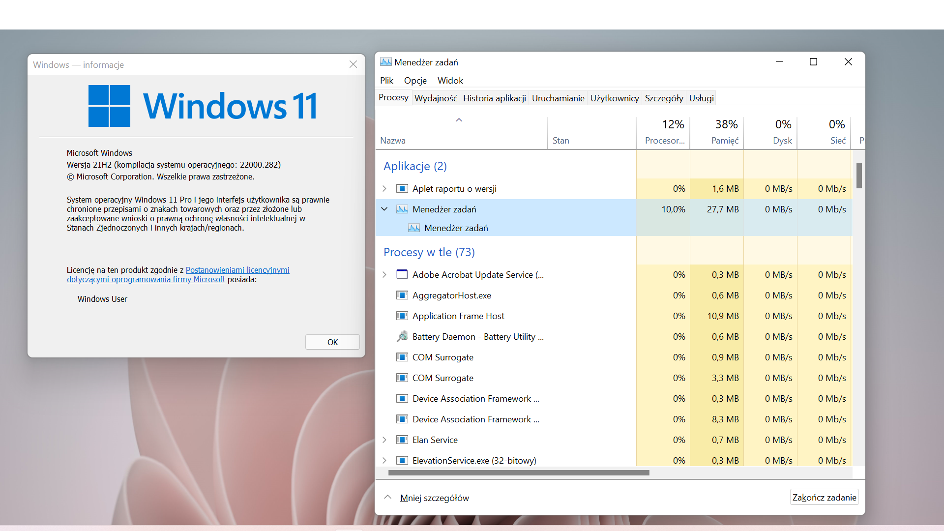

Does your Windows 11 task manager also "eat up" CPU resources at idle? :roll:
In the first release of Windows 11 used over 50% of CPU, after the last update it uses around 10%, but still much more than in Windows 10. :shock:
Win11 (22000.282).png (370.86 KiB) Viewed 2723 times

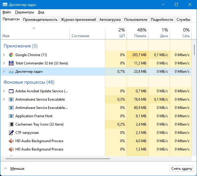

Tasm Manager in Windows 10 allocates 10 MB memory but in Win 11 (22000.282) as below: :o
Task manager in Win 11

gfilatov wrote: Mon Oct 25, 2021 6:18 pm Tasm Manager in Windows 10 allocates 10 MB memory but in Win 11 (22000.282) as below: :o
I can see that your Gen.5 CPU i7-5500U, although not officially supported by Windows 11, is doing much better (0,7% CPU Task Manager) than my also not officially supported Gen. 7 (10% CPU Task Manager) ;)

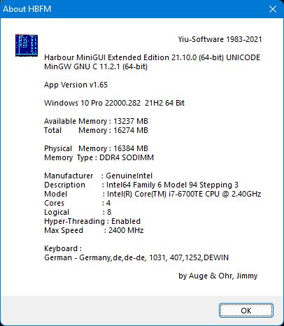

while my Windows 10 32 Bit Insider Version 10.0.21390.2025 have a "Time Bomb" at End of Month i have installed Windows 11 instead.
i use a "special" ISO which "skip" test of TPM, Secure Boot or GPT which i do not have in that Mini-PC.
my 1st try fail ... while i was connect to Internet and "Setup" was load from Internet ... :roll:
2 Ways : "clean" Install or "Inplace"
when call Setuo from "running" Windows than you do a "Inplace" where you can "hold" all Programm Setting
while i want to "destroy" old Insider Version i do boot from USB-Stick
you can get ISO from here (English Version)
Windows 11 22000
Win11-English-x64-GDR-ZERO-LIMIT.ISO (22000.194)
https://t1p.de/b6jt
22000.258.MVS-CONSUMER-OCTOBER-ZERO-LIMIT.ISO
https://t1p.de/4rg6
22000.282.Cobalt-X64-EN-US-XXXL-ZERO-LIMIT-V6.ISO
https://t1p.de/qctt
Windows 11 Dev-Kanal
22483.1000.Nickel-X64-EN-US--XXXL-ZERO-LIMIT-DEV.V8.ISO
https://t1p.de/3hml
! Note : ISO include "all" Version so you must use Version match to your Key (is in UEFI)
! Note : WIM File is > 4 GB so USB-Stick need NTFS ( not FAT32 )
after Install, without any Problem, i called Windows Update for "latest" Version.
i got it and installed also without Problem
but not all Hardware was recognize so i need to install them manual ( from Driver-Backup )***
*** run CMD as Administrator and type
DISM /online /export-driver /destination:C:\DRIVER_BACKUP
where "C:\DRIVER_BACKUP" is Target place
i have look at "License" and it was "digital sign" and activate
so i got 3 x OS on PC : Windows 10 32/64 Bit and Windows 11 64 Bit :D
"general" Win32 Apps work under Windows 11 like in Windows 10 ...
but again M$ have "clean up old Stuff" so WIMdiag.EXE is missing.
next Version also do not have WMIC.EXE so you have to re-write Script for PowerShell or ActiveX
my Xbase++ and HMG Apps do run ... and also new HBFM MiniGUI Version (still under Construction )
